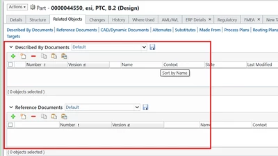

How do I get list of documents from item
Version: Windchill 12.0
Use Case: All documents are attached to item and I need to get a list of them in order to download them
Description:
I know how to search an item with the rest api and how to display all its metadata but I didn't find how to get list of child items which should be the documents I need to download.
Thanks for help.
Fred

Fadel
23-Emerald II
Sep 18, 2025 8:11 AM UTC
with item do you mean a part ? how documents are linked reference or describe link ?
Buiꓘa
6-Contributor
Sep 18, 2025 8:13 AM UTC
Yes, documentation linked to a part. I don't know when I get the part how to list the linked document.

Fadel
23-Emerald II
Sep 18, 2025 8:15 AM UTC
from the related objects tab you can see if its describe or reference doc :
