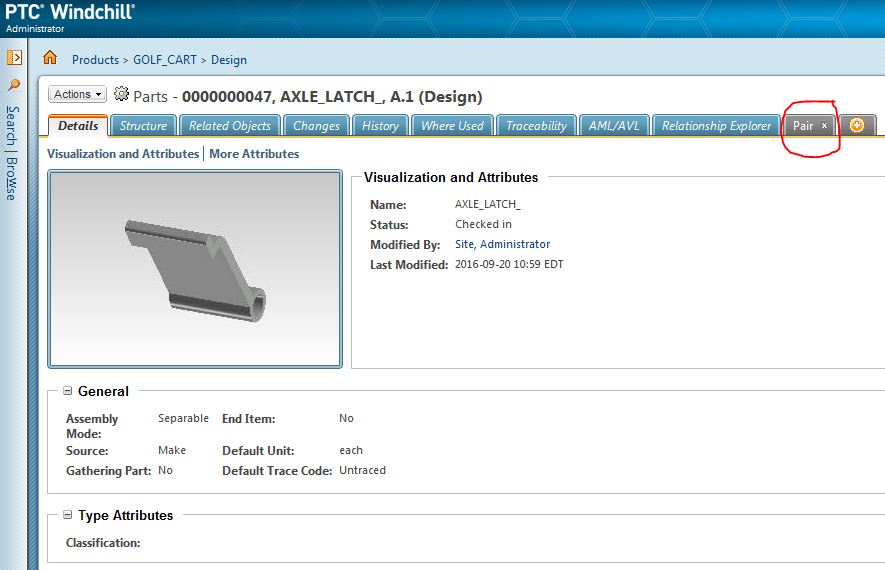

I would like to have an attribute control the display of a custom tab on the Part info page.
So:
1) if I add a Boolean attribute called 'Is Pair'
2) if the 'Is Pair' = false  Then   the 'Pair' tab will NOT be displayed
a) After the part is checked in
b) When the Info page is navigated to
3) if the 'Is Pair' = true Then   the 'Pair' tab will be displayed
Thanks for the help
SRM

Hi Scott,
Is the additional tab you created is added through Customization (action model) or created using New Tab > Customize option available out of the box?
Shirish
smorrison1-VisitorAuthor
January 19, 2017
Good question.
It will be added through Customization (action model).
Scott
ShirishMorkhade
January 19, 2017
Hi Scott Morrison,
To achieve this you can write your own validator which will first get IBA value from WTPart. Once you have IBA value you can then decide whether to display or hide custom tab.
Your validator code will looks something like below:

To hook this validator you can add below entry to site.xconf file and propagate changes by "xconfmanager -p" command:
<Service context="default" name="com.ptc.core.ui.validation.UIComponentValidator"
            targetFile="codebase/service.properties">
      <Option cardinality="singleton" order="0" overridable="true" requestor="null"
              selector="CustomTab4Part"
              serviceClass="ext.Validators.HideCustomTab"/>
   </Service>
Restart MS server and you're all set.
If IBA has value true, then Custom Tab will be displayed otherwise it will be hidden.
I hope this helps you!
Shirish
