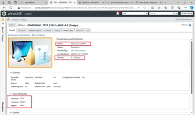

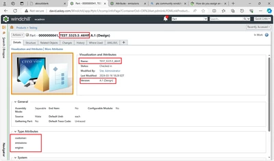

How does this look?
Notice the attributes were updated WITHOUT iterating the object, this test was done on a WTPart but this can work on an EPMDocument or any object type.
This was done using some code I wrote per your post.
Before
After
