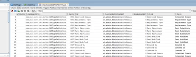

Please take a look into the LWCLocalizablePropertyValue table. here are the display values (with column for local)
good luck
AndreaP8-GravelAuthor
8-Gravel
September 28, 2020
Thank you! now I'm able to see the display value in the database, LWCLocalizablePropertyValue.value
and link it to the others tables
LWCLocalizablePropertyValue.IDA3B4-->LWCEnumEntry.IDA2A2
LWCEnumEntryLink.IDA3B4-->LWCEnumEntry.IDA2A2
LWCLocalizablePropertyValue.IDA3C4-->LWCMasterEnumerationDefinition.IDA2A2
I still miss how these values are linked to an object;
for example on  WTDocument normal strings vaues are linked :
WTDocument <--(IDA3A4) stringValue (IDA3A6) --> stringDefinition
How is the join in this case?
