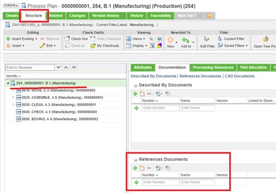

How linked MfgProcess and ReferenceDocument?
  • January 25, 2017
  • 3 replies
  • 1753 views
How linked MfgProcess and ReferenceDocument? I can't find this relation
January 25, 2017
com.ptc.windchill.mpml.MPMDocumentReferenceLink
March 1, 2022
Thank you. I now understand the full path. Unfortunately I am unable to find this relationship in the administrator [Manage Types] panel or the WTTYPEDEFINITIONMASTER. Without this connection, I am unable to view/understand the available/required relationship attributes.
HelesicPetr
March 2, 2022
Hello @vkomyshenets
You should go to the MFGProcessPlan structure and go to the Documentation.
There is a UI to link Process Plan or operation with reference document
This relation uses the com.ptc.windchill.mpml.MPMDocumentReferenceLink
