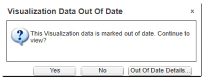

How not update EPMDocument attributes. Need to include as-stored baseline
So my team wrote a little utility to update some attributes on objects. Worked great but we are seeing out error and need to make a fix for drawings and assemblies. This is how we were checking out the objects:
//Checkout document
checkedOutDoc = (EPMDocument)WorkInProgressHelper.service.checkout(document, WorkInProgressHelper.service.getCheckoutFolder(), "").getWorkingCopy();
Everything as fine, object was iterated and the attribute were updated. Fast forward a few weeks and a user reported seeing the following.
This was odd since I remember kicking off a scheduled publishing job on these items myself and I am sure I selected to use the as-stored baseline. I attempted to republish this item again but in reading the WVS logs, I can see that it reports there is no as-stored baseline so uses latest as the alternative. Rut Roh Shaggy.
So cautionary tale. If anyone has the right sequence to update an object WITH the as-stored baseline and then check it in properly (bonus to trigger republishing), let me know. I will post what I find if I beat you to it.
PS-As of now, I know there should be a way to turn off the warning on out of date representations. Not sure if that is something I want to do. If I wanted to fix manually, it would be to download the previous iteration as-stored, update the drawing object only, check out then check in from a workspace. Very tedious.

@avillanueva , to be clear this has nothing to do with updating attributes per se.
This is a publishing As Stored where the system does not recognize or does not have an As Stored baseline?
Or is the Visualization marked out-of-date when in fact it is not out-of-date?

Yes, nothing to do with updating the attributes. I think using the WorkInProgressHelper in that manner only checked out the drawing but since not in a workspace, the dependents do not get included. On check in, the system did not create a new as-stored baseline (like it does from the workspace) so it just is not there. The WVS service just shifted to a backup in using latest and from there, normal system functionality takes over. Latest publishing jobs are checked so see if they are out of date if dependents change.

Thank you for sharing. I do not see any note where it references the as-stored baseline. I see that you are populating a collection but it appears to be one item. Am I reading that correct?
Feb 28, 2025 4:04 PM UTC
I apologize @avillanueva  -- I left out the as-stored!  Below brings the as-stored into the workspace along with the checked-out model, so that when checking it in, the new iteration also receives an as-stored baseline (with the same iterations as the iteration checked-out).  I tested on a 12.1 system and confirmed the as-stored baseline is created on the new check-in, and that it can successfully publish using that as-stored.  I haven't added the workspace cleanup here -- the remove from workspace is removing the object just checked in, but not its as-stored members, I need to add that. Also, when I had been exploring the API to fetch baseline members, I didn't fully understand how it was handling unresolved dependencies - may want to look at the as-stored before and after in your configuration if that is a concern.
Re your question about collection -- the API works on a collection, rather than on a single item, so I create a collection of one item to use the API.

		EPMDocument checkedInEPMDocument = null;
		WTCollection wtCollectionCheckedIn = new WTArrayList();
		for(Object o: wtSet) {
			if(o instanceof ObjectReference) {
				ObjectReference objectReferenceCheckinResult = (ObjectReference)o;
				EPMDocument epmDocumentCheckinResult = (EPMDocument) objectReferenceCheckinResult.getObject();
				LOG.debug("Checked in: " + epmDocumentCheckinResult.getDisplayIdentity().toString());
				LOG.debug("OID: " + epmDocumentCheckinResult.getPersistInfo().getObjectIdentifier().getStringValue());
				wtCollectionCheckedIn.add(epmDocumentCheckinResult);
				checkedInEPMDocument = epmDocumentCheckinResult;
		EPMWorkspaceHelper.manager.removeFromWorkspace(epmWorkspaceForCheckout, wtCollectionCheckedIn);
		return checkedInEPMDocument;
