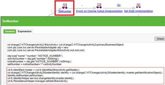

Here is example from WF Activity how to set number activity to a format "CN+/+AtivityNumber"
wt.fc.Identified master = (wt.fc.Identified)thisActivity.getMaster();
wt.change2.WTChangeActivity2MasterIdentity identity = (wt.change2.WTChangeActivity2MasterIdentity) master.getIdentificationObject();
identity.setNumber(setNumber);
wt.fc.IdentityHelper.service.changeIdentity(master,identity);
wt.fc.PersistenceHelper.manager.refresh(thisActivity);

Set the Lifecycle template to advanced and run own workflow in the state where you need.
Place an expresion robot with code in the workflow.
Write code to change the number  in the WF .

Can you give some references or examples?
