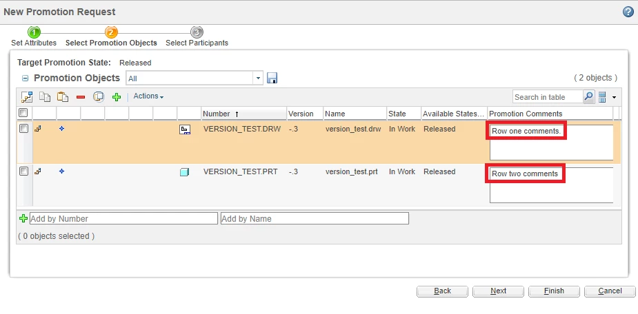

Does anyone know the syntax required to access the comments entered for each promotion object line on a promotion request?
I have the syntax necessary to loop through each object in the baseline, but these are the actual EPMDocuments and don't contain the comments that are part of the promotion request (as far as I can tell.)

What is the syntax necessary to get each row in the promotion request itself instead of just the objects on the baseline?

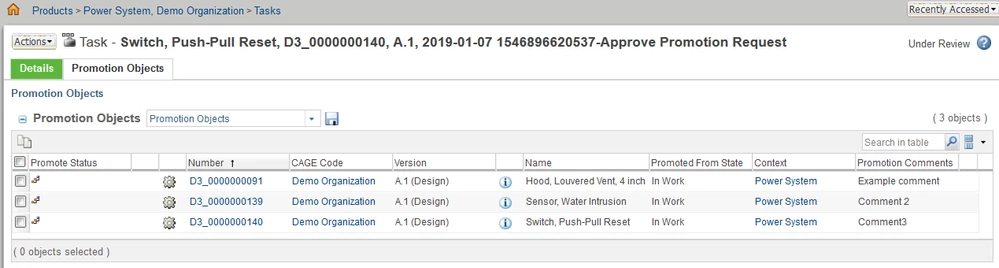

@TomU Have you thought about using the Promotion Objects table in your Workflow Layout?  It will show the Comments column.

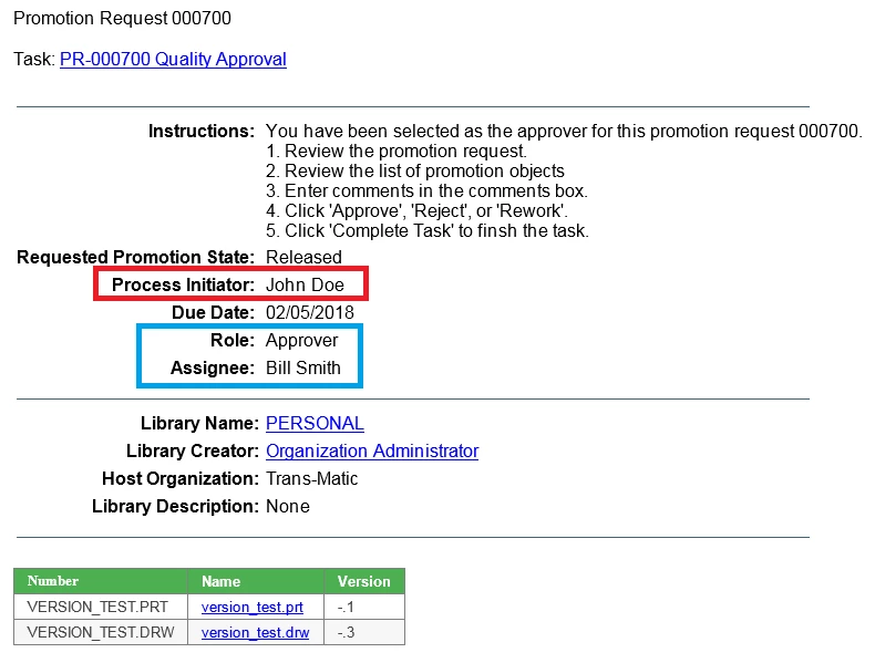

I'm trying to get this information into the email messages.  See the table at the bottom of this picture:
January 8, 2019
Ah - yes so a little less direct.
Won't help you now but we are going to be working on some more customization and then configuration points for the notifications.
Let me noodle on this some.  Will you be at the PTC/USER sessions coming up?
