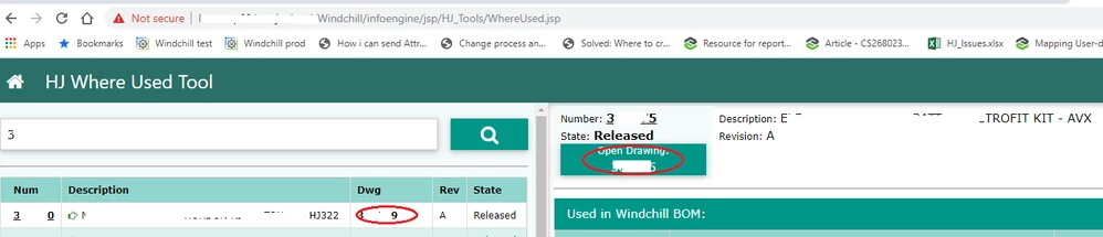

You can also put any JSP file into the Windchill\codebase\infoengine\jsp folder and run it without any additional setup.
There you can create a simple interface and use rest services to fetch any data, including the pdf of drawings available to the currently logged-in user.
Here I made a tool that checks part usages across multiple databases and gives the user an option to download drawing PDF.
