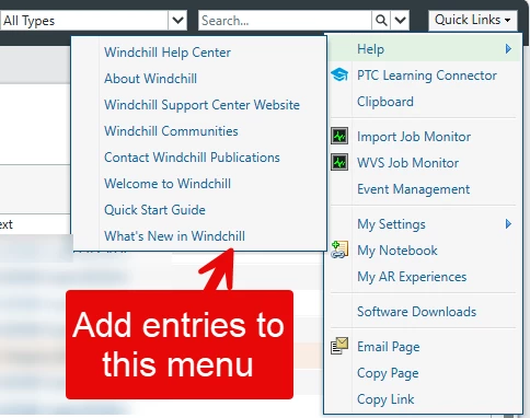

How to add a new entry in the help menu?
Version: Windchill 13.0
Use Case: At my company, we've been working on a business specific help wiki, using SharePoint. This would include help tutorial pages on how to do common business specific tasks, using business specific language. The idea of this is to reduce the amount of time it takes to bring new users up to speed, and to reduce the amount of time spent supporting users on tasks that they don't do very often. We want to make it easy to access this wiki by including a link to it from the Windchill help menu.
Description:
The question I have is "how do I customise this menu to add the extra link?". Up to now we've customised the header to include the link, but it would appear that option is being removed in the future, now the ability to add banners in the UI has been added, presumably for SAAS customers. Using the new banner option in the UI covers over where the link would be in the header, making it unsuitable for us. Adding the link to the company specific help page in the help menu would be a great help.
I found this page: Solved: How to add a new menu item with link to url under ... - PTC Community but it is for Windchill 10.2 and involves having to recompile resource bundles, which I'm happy to do but I'd like to know if there's a more up to date way of doing this, or a more supported way for future use?

This is defined in the config/actions/navigation-actionModels.xml and navigation-actions.xml files. You should copy relevant sections into the custom-actions.xml and custom-actionModels.xml files and make your changes there. The help submenu is define in both.

The model shows the list of links as they appear. Their definitions are below in the actions file:

You can see examples above where they call out a direct URL.
