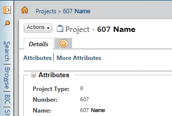

Can anyone help on how to add the default project attribute "Number" in the Title of the Project that by default shows only the Object type and the Name?
See the picture below:
Thank you in advance.

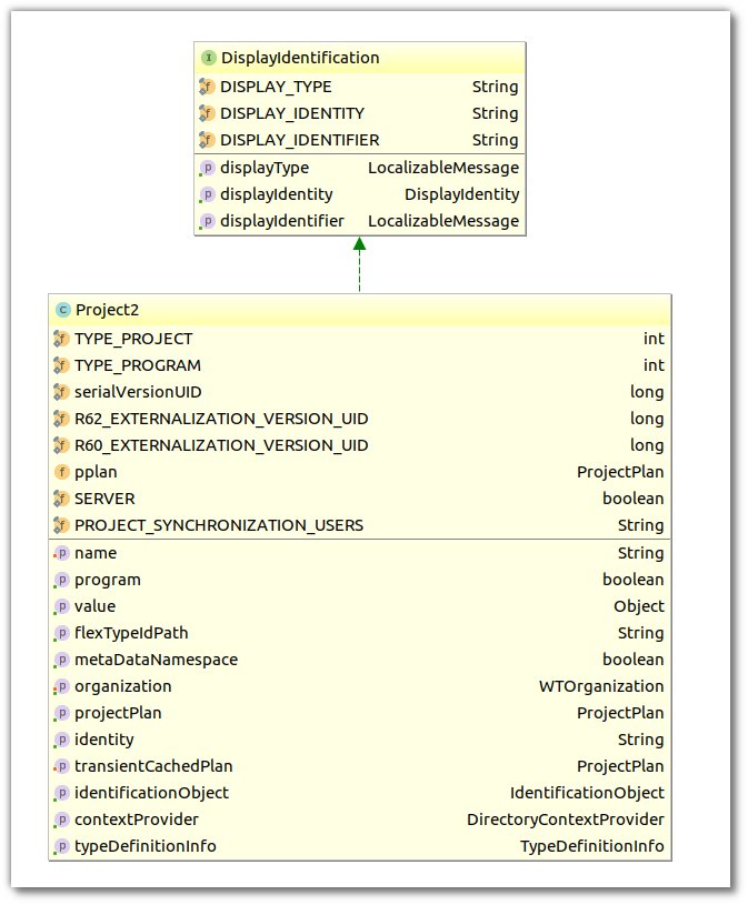

Take a look at  http://www.ptc.com/cs/help/windchill_hc/wc102_hc/index.jspx?id=WCCG_UICust_InfoPages_InfoPages&action=show
Chapter Item Identifications Customization
Basicaly, you need to create a class to extend wt.identity.DisplayIdentification
and register this new delegate, with a line like
<Option cardinality="duplicate" order="1" requestor="wt.projmgmt.admin.Project2" serviceClass="ext.custom.MyCustomDelegate"/>
take a look at codebase/service.properties.xconf to get the full syntax to use in site.xconf.
By default, the project object implements the DisplayIdentification interface. But you can easily use your own implementation.

I assume that in this way only the Projects and programs will be affected. Correct?
February 6, 2017
Yes, Program is a subtype of Project, so it's affected too.
