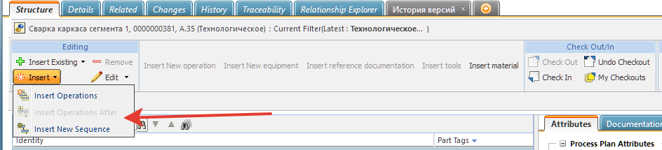

Okay. But maybe might I to register my own GWT-action in system?
And may I insert my action in existing group, like in picture? Because they are displayed after target group.2017-02-06_08-52-05.png
