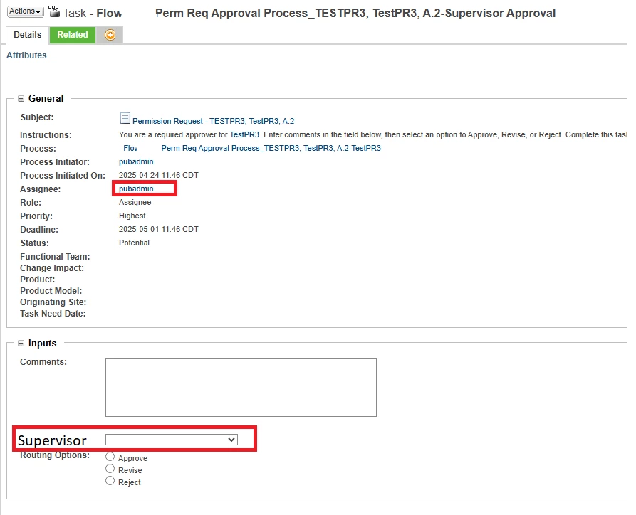

Tried approach:

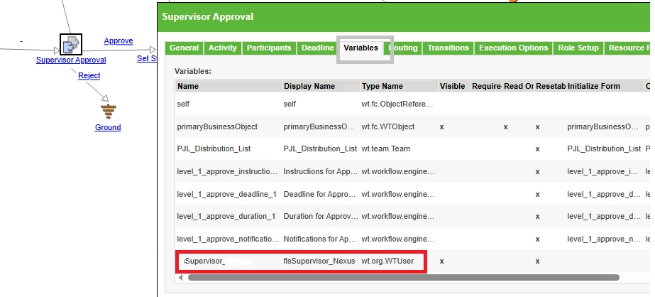

1. I have a custom workflow in which, through an expression, I obtain the attribute(of primary business object) that holds user value. For this user, the reporting manager(type: WTUser) is retrieved from the AD.
2. A workflow variable 'supervisor' of type WTUser is created and the WTUser value obtained in step-1 is assigned.

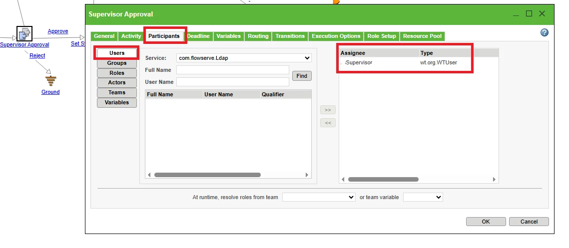

3. In the workflow activity(Participants tab --> Variables section), the 'supervisor' variable is defined as 'Assignee'.
Expectation: Task, if generated successfully, should be assigned to the 'supervisor' user.
However, on the task page, the variable appears as a dropdown and the task is assigned to the admin.

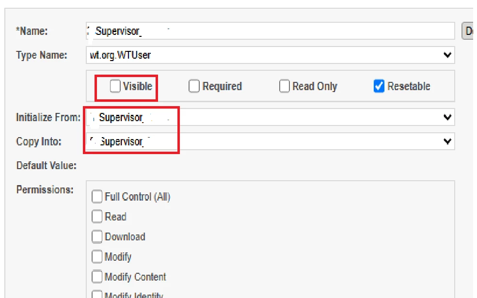

Thanks to my colleague, the solution here is to update the variable properties with:
1. Disabling visible property.
2. Declare the same variable in both 'Initialize From' and 'Copy Into'.
This ensured to assign the WTUser value generated through expression, to the approval task.
