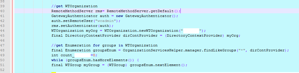

I'm creating a JSP that would list all the groups of a specified organisation in the Windchill.
To prevent the authentication window, I'm trying to use RemoteMethodServer API and the suggested method of authentication from CS254321 in PTC K-Base.
But i still get the authentication window when i try to access this JSP.
Any help?

How are you calling this JSP? Is it from an action from Windchill or a stand alone? If it is a standalone and if the JSP is in one of the protected resource locations, you will not be able to access the resource without authentication.

It is a standalone JSP and it resides in the <WT_HOME>\netmarkets\jsp.
Is there any other way that i can achieve my need? My actual requirement is to get the list of groups from an organisation in Windchill and process it in an external Java code, and in future try to add some users to an existing group. Any suggestions.

What if you explicitly set the username and password?
rms.setUserName("wcadmin");
rms.setPassword("pwd");
