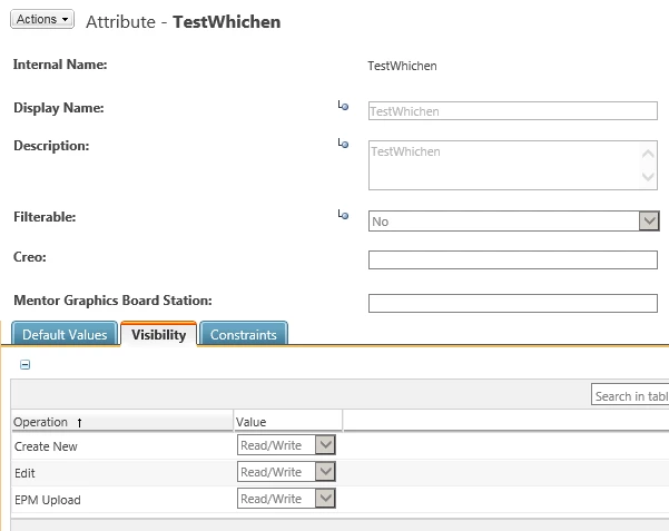

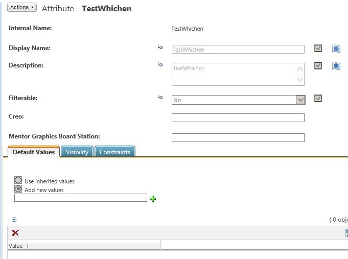

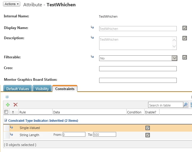

I want to use API  to change my customized attribute of EPMDocument, the attribute setting in Utility  as attachment show. Who can help me?
Always failed, the error info is:
Exception in thread "main" java.lang.reflect.InvocationTargetException
  at wt.method.RemoteMethodServer.invoke(RemoteMethodServer.java:795)
  at com.cisco.whichen2.SetEPMAttribute.main(SetEPMAttribute.java:47)
Caused by: com.ptc.core.meta.container.common.ConstraintException: The value for TestWhichen cannot be changed.
  ... 2 more
