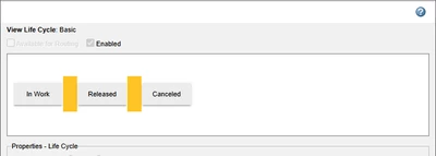

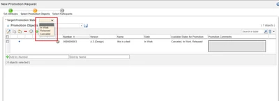

Use Case: I would like to reorder the Target Promotion state in the drop down list being shown for a New Promotion Request to match the order in the Life Cycle Template.
Description:
I have added custom states to our windchill install.
This is the order of the states in the life cycle template
This is the order they are showing up in the New Promotion Request drop down list
How do you change the order in the drop down list to match the Life Cycle Template?
I would like the drop down list to read as the following:

HelesicPetr
Jun 13, 2024 4:14 PM UTC
Hi @danders238
Unfortunately, the DataUtility that cares how to display the list, sorts it just by String so there is no option how to change it by any configuration.
You could just rewrite the DataUtility where you sort the list as you need.
So only customization can change the behavior.
com.ptc.windchill.enterprise.maturity.dataUtilities.PromotionStateSelectionDataUtility

Hi @danders238
You could try to set order by enumstomization in wtCustom (wt\lifecycle\StateRB)
https://www.ptc.com/en/support/article/CS366297
RELEASED.value=Released
RELEASED.shortDescription=Released state
RELEASED.order=4
OBSOLETE.value=Obsolete
OBSOLETE.shortDescription=Obsolete state
OBSOLETE.order=5
 If you use Windchill 12.1+ you can modify it in a website UI
This is just advice to try. Iam not sure if it would work but It can 😄
I do not know an another way how to change the order in the list instead of customization.

Jun 12, 2024 9:01 PM UTC
Hi PetrH,
I tried what you mentioned and found the drop-down list to still be out of order.
Using OBSOLETE.order=5 with the states now has them showning up in the enumCustomize utility in the correct order but not in the drop-down list.
Any other ideas, or will we need to change the source code for the page?
Thank you,
Don A

18-Opal
Jun 15, 2024 11:41 AM UTC
@danders238
I saw your post and thought it would be fun to figure out.
It's doable for sure.
In my example I used the OOTB lifecycle
Using OOTB sorting Promotion State looks like this.
After adding customization sorting Promotion State look like this.
Note the order is the same as the LifeCycleTemplate. 😀
This was a fun one to figure out for sure.  Keep 'em coming!
A word to the wise, I did examine the OOTB code that displays this and OOTB it is sorted alpha-numerically in the code. So, no matter what you do upfront OOTB it will still be sorted alpha-numerically.
