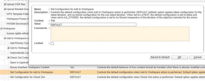

How to change the standard workspace load rule for all users?
Short question: How to change the standard workspace load rule "load as saved" to "load newest" for all users?
HelesicPetr
September 25, 2023
Hi @MP_9215870
one important point, folowing configuration does not affect function "Open in Creo"
Set the preference on the site or org level to LATEST
"Set Configuration for Add to Workspace" or "Set Configuration for Check Out"
then delete all child instances, this resets all users configuration to the site level.
PetrH
