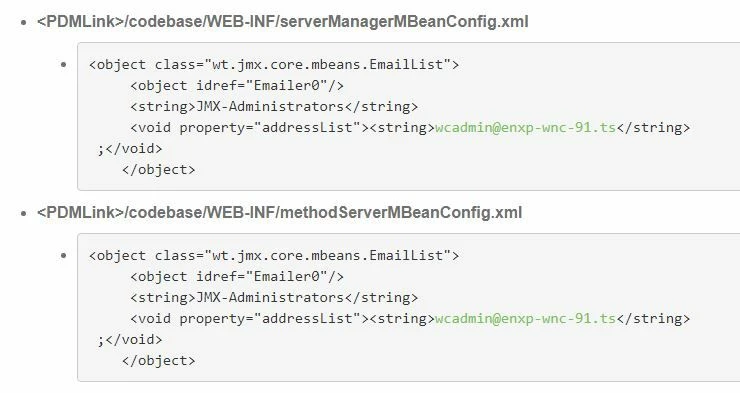

Hello everyone, please tell me, can I create a mail to be able to send emails from the site Windchill? I don't have a mailing address right now. I tried to perform c vladislav728@gmail the following steps, but I could not send the email, but there was no error

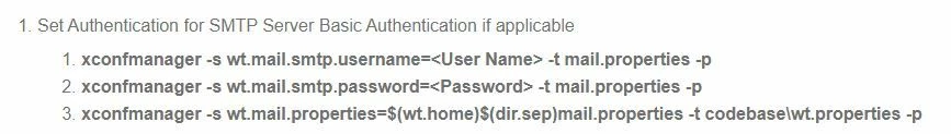

Hi @VladiSlav ,
Do you have SMTP Server hostname in place? Since you're using gmail id, I believe you will need to have "smtp.gmail.com" as wt.mail.mailhost in wt.properties file.
Also take a look at this KB article which talks about configuring SMTP mail server for Windchill.
https://www.ptc.com/en/support/article?n=CS46949&language=en&posno=1&q=smtp%20windchill&source=search
Hope this helps you!

ShirishMorkhad, please tell me how to find out if I have SMTP Server hostname?
And I do not understand how to learn what at me <mail server hostname> and <port>
