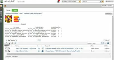

Hello everyone, I'm trying to implement @breed  example https://community.ptc.com/t5/Windchill/JSP-Page-to-Set-State/m-p/238010#M28450. How to put all the data in the table to look like in the tables below?
And how do I make sure that when I click on the "Search" button I stay on the same page and the data is updated?
All the code I wrote in the JSP-file customHomePageAction.jsp ( codebase/netmarkets/jsp/myCompany/customHomePageAction.jsp)

Best answer by VladiSlav
Hello, there is a video of training for example from the documentation
https://www.youtube.com/watch?v=-14BSAwteVw&list=PLjm4gmbLQwoeqQSP7xUhCnInGknqTBAZV&index=2
VladiSlav17-PeridotAuthorAnswer
February 12, 2020
