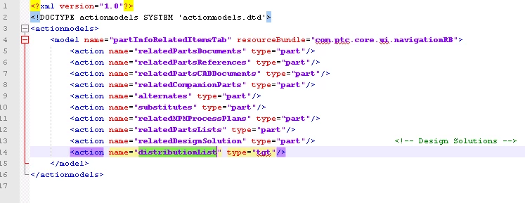

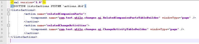

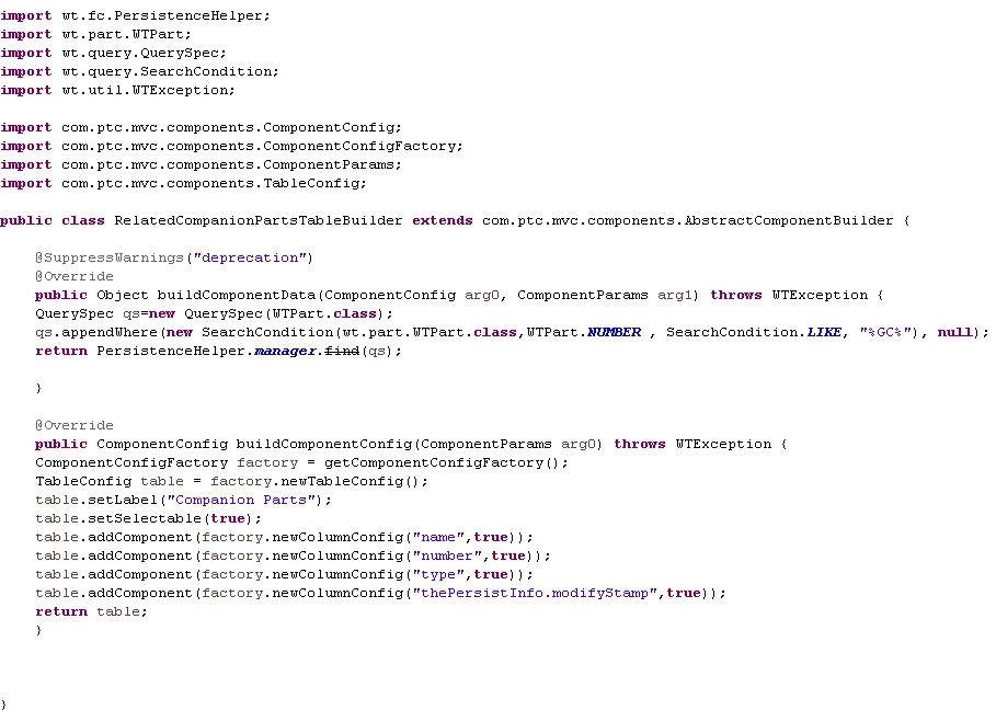

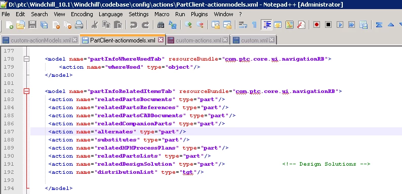

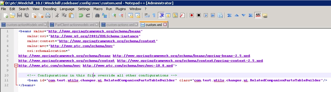

It sounds very simple to me, so I tried to realize it in my testing instance. Just to see how a new table integration works in Windchill. I have done that before only in Windchill 9.1 with JSP code. Point 4 and 5 are not so clear to me so I have done it like shown in the screenshots. For point 4 see screenshot3_custom-actions.xml. For point 5 I tried two options, first with the custom-actionmodel.xml and second with the PartClient-actionsmodels.xml directly (see screenshot4 and screenshot5)I. But both options don't give me a table in die relations tab in Parts. In screenshot 6 you can see the registering of the custombuilder in the /mvc/custom.xml file. All steps did not bring me success. My code can be seen in screenshot2.

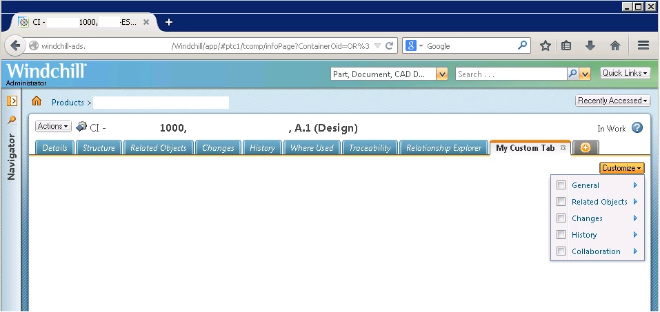

My goal at the end is to create a tab manually in die system via the GUI and use the customize button to add my custom table (see screenshot1). My custom table should show WTChangeActivity2 objects which are linked to a document which I would like to realize with the method ChangeHelper2.service.getAffectingChangeActivities.

1.       Your component builder Java Code:
package ext.abb.dmpc.builders.table;
import com.ptc.mvc.components.AbstractComponentBuilder;
import com.ptc.mvc.components.ColumnConfig;
import com.ptc.mvc.components.ComponentBuilder;
import com.ptc.mvc.components.ComponentConfig;
import com.ptc.mvc.components.ComponentConfigFactory;
import com.ptc.mvc.components.ComponentParams;
import com.ptc.mvc.components.TableConfig;
import com.ptc.mvc.util.ClientMessageSource;
import ext.abb.dmpc.builders.table.utils.TableHelper;
import wt.util.WTException;
// This annotation is VERY important.
@ComponentBuilder("ext.com.builders.table.RelatedCompanionPartsTableBuilder")
public class RelatedCompanionPartsTableBuilder extends AbstractComponentBuilder{
   private static final String RESOURCE = "ext.com.CustomTabRB";
   private final ClientMessageSource messageSource = getMessageSource(RESOURCE);
   @Override
   public ComponentConfig buildComponentConfig(ComponentParams paramComponentParams) throws WTException {
          //get the ComponentConfigFactory
          ComponentConfigFactory factory = getComponentConfigFactory();
          //get an instance of TableConfig
          TableConfig table = factory.newTableConfig();
          // General table properties
          table.setId("ext.com.builders.table.RelatedCompanionPartsTableBuilder");
          table.setSelectable(true);
          table.setLabel(messageSource.getMessage("COMPANION_PARTS"));
          table.setShowCount(true);
          table.setActionModel("mvc_tables_toolbar");
          //add columns
          //name
          ColumnConfig col1 = factory.newColumnConfig("name", true);
          table.addComponent(col1);
          //number
          ColumnConfig col2 = factory.newColumnConfig("number", false);
          col2.setInfoPageLink(true);
          table.addComponent(col2);
          //type
          ColumnConfig col3 = factory.newColumnConfig("type", true);
          table.addComponent(col3);
          // Last Modified
          ColumnConfig col4 = factory.newColumnConfig("thePersistInfo.modifyStamp", true);
          table.addComponent(col4);
          // If you want different column name as Display name, use setLabel("New Name") function on column
          // If you data as link use setInfoPageLink(true) function on column
          return table;
   @Override
   public Object buildComponentData(ComponentConfig paramComponentConfig, ComponentParams paramComponentParams) throws Exception {
          // your code which return a Query result containing the desired Parts
In your other custom Table builder use the annotation: @ComponentBuilder("ext.com.builders.table.RelatedChangeActivitiesTableBuilder”);

3.       Define A new custom action in InfoPage-actiomodels.xml in the section where you want the new menu item to appear:
<action name="relatedCompanionParts" type="tgt"/> <!-- Companion Part -->
<action name="relatedChangeActivities" type="tgt"/> <!—Change Activities -->
4.       Adding a custom TAB
Rename is as you wish.
Export the tabs from Windchill Shell using the with the command
java com.ptc.core.ui.ixb.ClientTabExport “My Custom Tab”.
A jar file will be exported which contain all tabs with the name “My Custom Tab”.
Change the content of the XML (TAG-ClientTab-0.xml) or create (MyCustomTab.xml) it manually as follows:
<?xml version="1.0" encoding="UTF-8" ?>
<!DOCTYPE ClientTab SYSTEM "standardX24.dtd">
<ClientTab>
<csvname>My Custom Tab</csvname>
<csvobjtype>wt.part.WTPart</csvobjtype>
<csvtabsetkey>infoPage</csvtabsetkey>
<csvcomponents>[{&quot;name&quot;:&quot;relatedCompanionParts&quot;,&quot;type&quot;:&quot;tgt&quot;},{&quot;name&quot;:&quot;relatedChangeActivities&quot;,&quot;type&quot;:&quot;tgt&quot;}]</csvcomponents>
<csvparentContainerPath>/</csvparentContainerPath>
</ClientTab>
The changed/ created XML can be imported with the following command:
windchill wt.load.LoadFromFile -d "D:\ MyCustomTab.xml.xml" -CONT_PATH "/" -u “user” -p “password”

6.       Changes is custom.xml
In custom.xml (wtCustom\codebase\config\mvc\custom.xml) ad the following line:
       <bean class="ext.com.builders.table.RelatedCompanionPartsTableBuilder"/>
       <bean class="ext.com.builders.table.RelatedChangeActivitiesTableBuilder"/>
