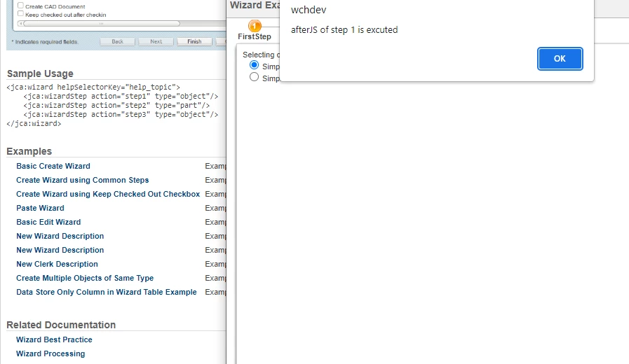

First I would advice to check wizard examples in windchill documentation
AfterJS can call jscript to reload table or next page of wizard.
https://support.ptc.com/help/wnc/r12.1.1.0/en/#page/Windchill_Help_Center/customization/WCCG_UICust_ConstructWizards_WCClientArchWizard_Ex2.html
