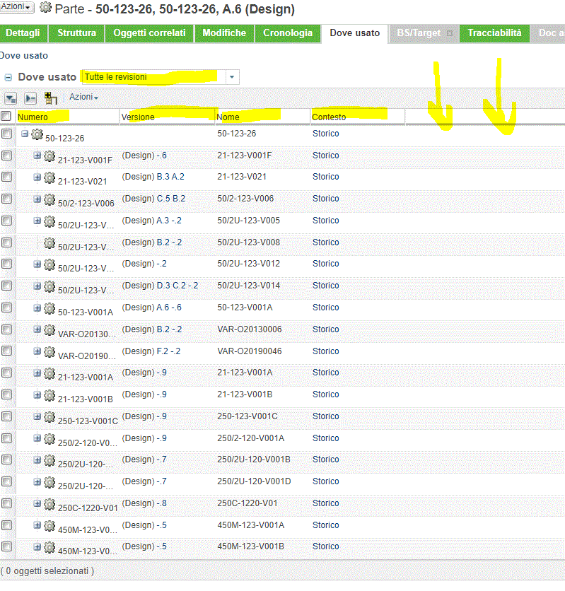

Hello everybody,
how can i add some attribute columns to the wtpart where used tab view?(see attachment)
Matteo.

Hello @Matteo_1987
You can add your own view by LoadFromFile

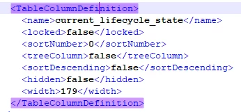

You just need to correct Admin user information in a attached xml file.
Define columns as needed. IBA values or system attributes.
Example how the column name should be defined in a xml load file you need to export some view from other tables where you can modify views.
IBA definition is easier then system atribs you just use internal names.
Last thing is to load the xml file to Windchill by the windchill shell and the loadfromfile utility
windchill wt.load.LoadFromFile -u user-p pass -d TAG-TableViewDescriptor-0.xml

You need to overwrite the OOTB table view.
com.ptc.windchill.enterprise.object.WhereUsedTableView
but it's not supported...
See also the archived idea
https://community.ptc.com/t5/Windchill-Ideas/Adding-extra-features-to-Where-Used-Tab/idi-p/460854
unfortunately not enough user voted for this idea

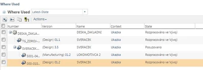

We added the State column in 11.2.1.  The Where Used table is not a straightforward table as others, as it has two distinct modes - the Latest and All Revisions.   Latest is most like a normal table view, however in All Revisions all matching Revisions (latest on that revision) are show per row.  The challenge with the All Revisions view is finding an elegant way to show related attributes when multiple versions are seen in a readable and navigable format (eg still easily expand to parents / children without overwhelming the UI)
In the future we do plan to look at further attribute support for the Latest View.  For the All Versions we held some UX sessions with users and are still considering potential paths.  No current release timeline for this work at this time.

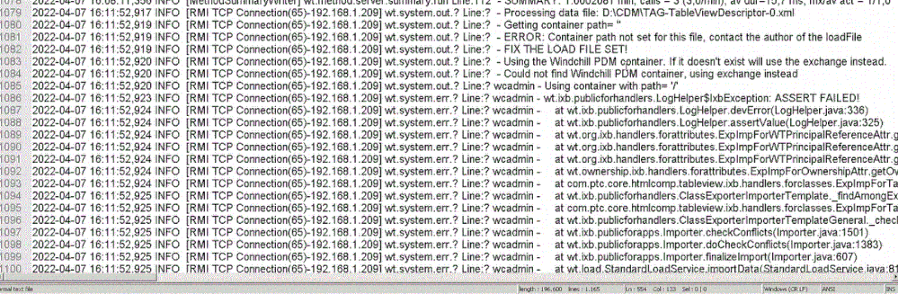

Hi Petr,
I tried to insert the files after modifying it (see attachment) but an error regarding the Container Path appears in the method server.
What am I doing wrong?

Hello @Matteo_1987
can you show full error please?

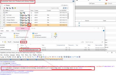

there is Assert Failed. In my opinion the user admin is not correctly defined in your XML.
there should be LDAP address in ufid.
I would export any table view from custom View List.
For example go to a product folder table.
Open Customization window for the table
chose Site view created by admin (ootb)
use export button.
Check the ZIP File and open xml file where the user is defined.
Use this user ufid in your custom where used xml definition
