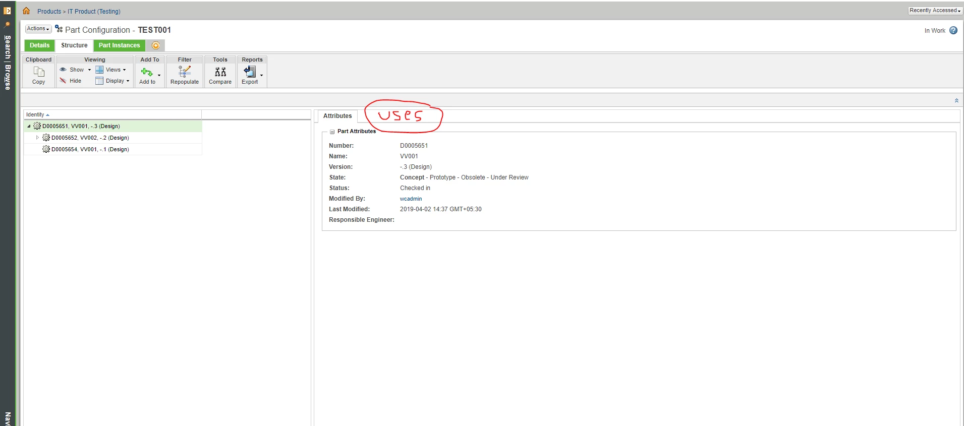

How to customize WTPart structure tab page in windchill ?
In Structure Tab can not find uses tab. This happen only in case of Part Configuration.
So how to add uses tab under Structure tab.

A Product Configuration is created to determine which versions of items to use in a Product Instance.  It is not meant for activities beyond this purpose and does not support editing of the BOM.

         Is their any alternative to this?
April 4, 2019
What use case are you trying to solve?
