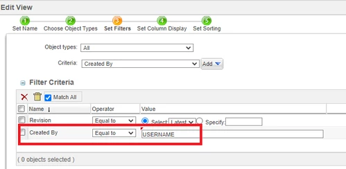

How to Define Created by 'Me' or 'Current User' in the Filter Section When Creating a Custom View in
Version: Windchill 12.1
I want to create a customized view in the 'view' section of Windchill tables. Instead of showing objects created by many people in that table, I want to see only the objects created by the current user. How can I achieve this?"

Hi @Emrec@n
There is not general condition created by me, but each user can crate own custom view with own condition with own name.
So each user can do it and filter by his name.
Unfortunately not all table views can be configured by conditions.
PetrH

Hi @Emrec@n
It is not strange.
You have a home page where you can view your own work check out work and so on..
No one needed this filter in normal folder table or others places if you can easily create own view with own name.
You have to understand If easy workaround exists, PTC does not invest a time to create something that is not needed.
