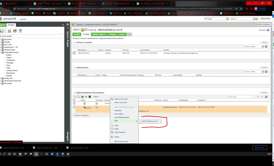

Is it possible in Windchill to prevent the download of additional files pdf, dxf, dwg (see image 2.png) of a representation?
I found in the support an article https://www.ptc.com/en/support/article/cs49421 which reports to the policy on the derived image object.

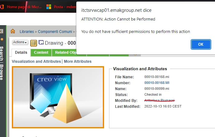

If I apply it and deny the download, the representation is no longer displayed and I cannot open it with creo view.(see image 1.png)
What other ways are there?

You should be able to grant READ but not DOWNLOAD - separate ACLs - for this object type.
October 13, 2022
Sorry, but I did not understand.
if I put the reading policy it is not good because I have the permission to visualize but I can still download the dxf file.
I need to prevent the download of the additional file that is created with the representation,
I tried to allow reading and deny the download but the result is that I don't see anything anymore
22-Sapphire I
October 14, 2022
I stand corrected on this - just tested.
Permissions on the Derived Image object apply for the published viewable.  Users need to be able to download the viewable to view in Creo View.
To deny download for attached files (regardless of how the files got there), Deny Download for the EPMDocument (could apply to a subtype of EPMDocument such as CAD Doc).
Hopefully the users who you are needing to deny for this are not CAD users.
