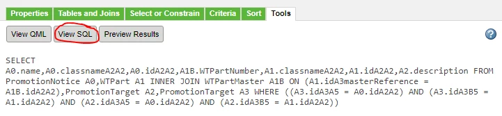

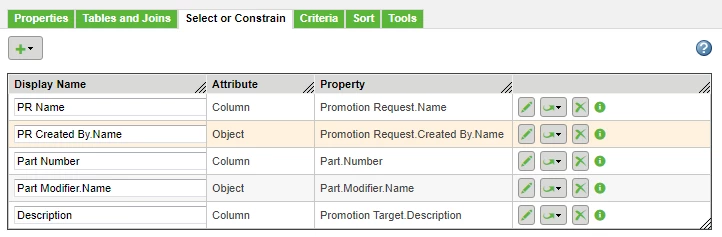

Hello everyone, please tell me how to determine from which table in the Database the elements are taken to build a table on the site Windchill? I have full access to the files and the Database.

Define all the fields you want to get from those objects:
And then have a peek at the SQL query that builds the resulting table:
That should give you a good start.

ello, I am using MS SQL and Windchill_11.1, I want to learn how to determine which table in the database the items were taken from. For example, for the table " Promotion Request"
