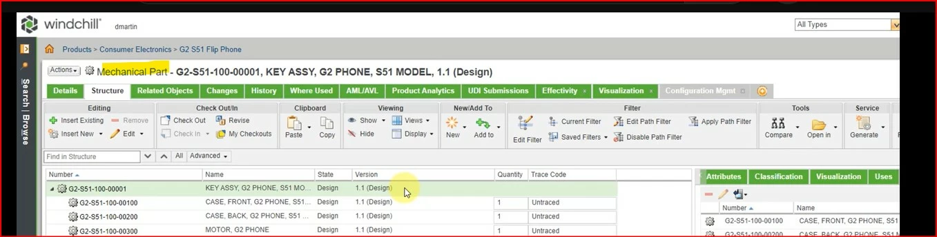

I went through some PTC articles and also youtube video where I found that we can have option of Electrical or Mechanical before starting Part Name, number etc. How I can enable that?
Attaching ss for reference.

The different type of WPTart is set during creation.
Open a wtpart new wizard and you can see different type of wtpart if it is configured
Also if the wtoart is autogenerated during CAD Document check in you can set the specific type of WTPart on the CAD Document type by type and attribute management.
If you want to create different BOM as a mBOM you need to use Transformer BOM tool

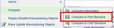

if you want to see difference you can use compare structure function

  • WTPart type -  to set the specific type like "Electrical"  with that you can apply specific business rules to this "type" of parts.
  • WTPart view - in your screenshot you see "Design" after the version on the top node. By default, there is a "Manufacturing" view you can filter your structure by view or check the WTPart history to see if a "Manufacturing" view of this part exists.
