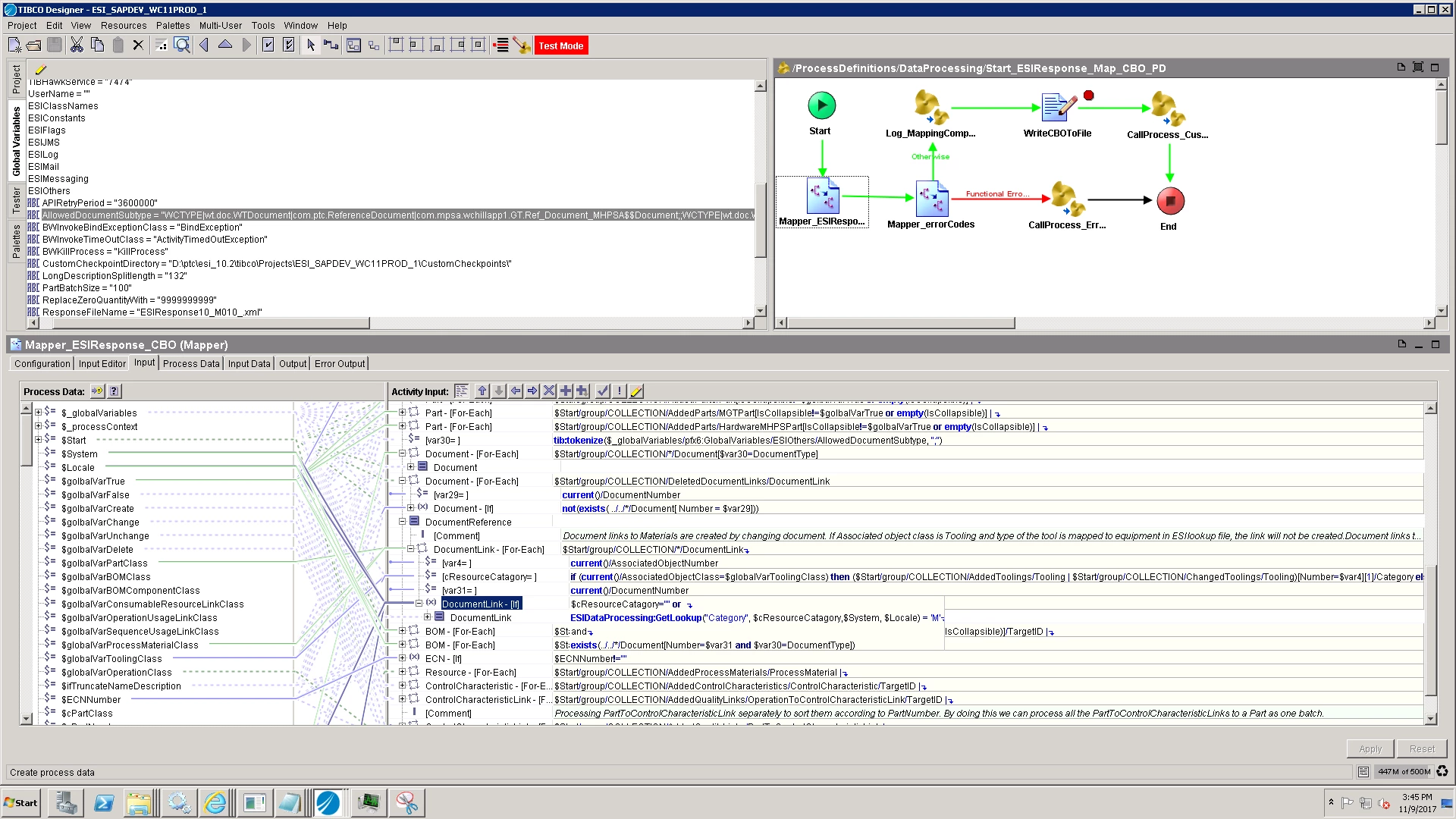

November 9, 2017
If you can pass "doctype" in the ESI response, you should be able to filter in Tibco.  We have a filter in place so that only certain document subtypes are added to the CBO and passed to SAP.  Basically, you create a global variable that contains the list of allowable "DocType"s.  Then, in CBO mapping, (Document, for-each and Document Reference Link, for-each), filter the response file based on a match between the global variable values and the "doctype" attribute.
Please take a look at the attached Tibco screenshot and feel free to followup with any questions.
Good Luck,
Casey

November 14, 2017
Unfortunatelly we don't use TIBCO as a middle layer, but ActiveMQ and Bizztalk.
The customization was done by extending ESIBOMRenderer by adding new getEPMDocument and getDocument functions, which after calling their super, will call a custom function to filter out the unwanted Documents and their links from the collenctions.
