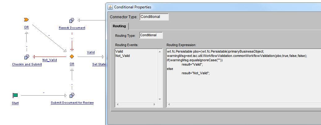

Hi Louis,
You can also build in a a check in the workflow using a conditional connector that checks if the object is checked out after the user completes the task, if it is checked out route it back to the person with a task to check in and resubmit.check.jpg

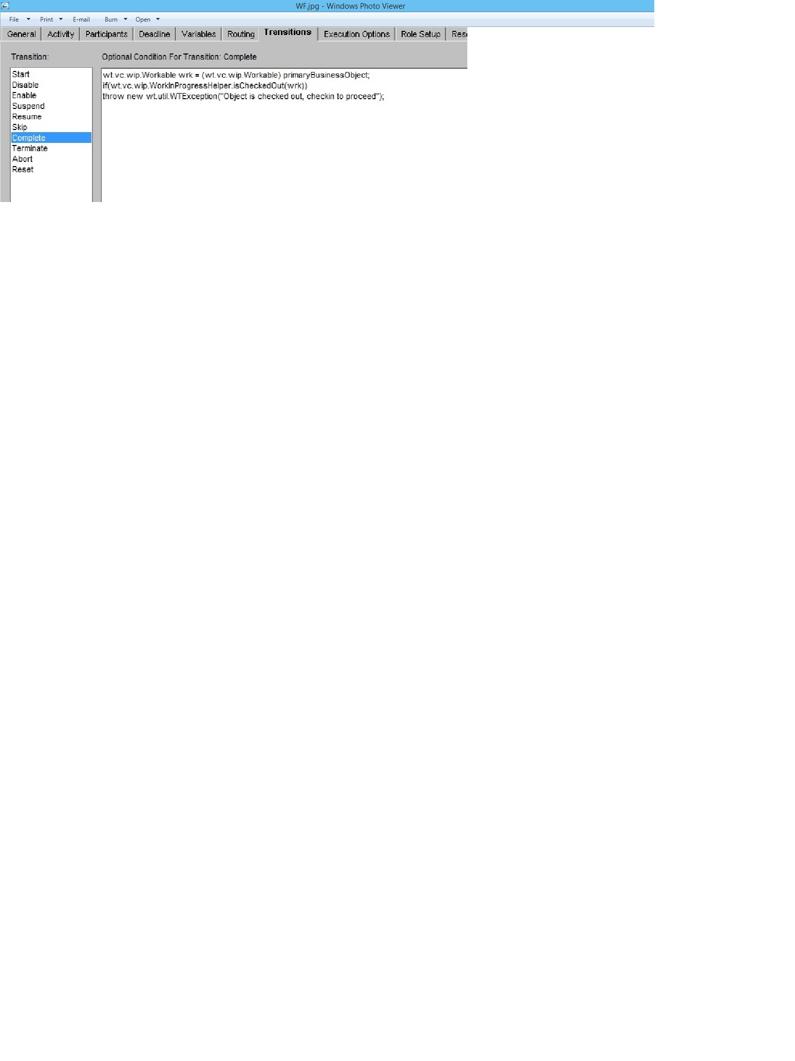

Hi Luis,
You can also try using below code in the complete transition:
wt.vc.wip.Workable wrk = (wt.vc.wip.Workable) primaryBusinessObject;
if(wt.vc.wip.WorkInProgressHelper.isCheckedOut(wrk))
throw new wt.util.WTException("Object is checked out, checkin to proceed");

Also, if your activity forces multiple users to complete the task then the last suggestion of adding an expression may not work as the complete transition will fire only when the last user completes the task.
