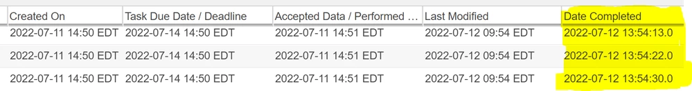

I noticed that the columns with dates and time are not formatted the same in my report. Is there a way to format date and time properties in a Report Template in Query Builder?
I thought maybe a database function or a java method would help, but I can not figure out which.

It would be a huge improvemnt to have a basic datetime formatting DB function, but sadly does not exist to my knowledge (unless in version beyond 11.1).  What you have to do is use concatenate with say, getyear([date]) "-" getmonth([date]) "-" getday([date]) if you wanted a format like "2023-12-08" from a full datetime.  I've also done substring(tocharacter([date]),1,10) which converts the date to a string and then pulls the first 10-characters starting with the first character.  Either way works.  The first gives you more flexibility in how you want to show the date.

Do you know how to prevent the formatting from changing? In the image below you can see most of the data columns have the same formatting but the "Date Completed" column is different.
December 8, 2023
No, I don't know of a way to have those displays "normalized" in the generic, untouched, query builder report.  Honestly I don't even know why they're stored differently in the DB.  That's also an assumption - the fact they're stored differently.  Truth is, most of my interest regarding date/time stamps are only on the date itself for reporting purposes.  I typically only get into actual timestamps when I'm doing a forensic investigation of something that "went wrong" in a workflow process or something.

Another way to format the date in your report is to do the below:
You can use a - or / in the format as well.

Here is the link to where I found this solution.
https://www.ptc.com/en/support/article/CS139088?source=search
