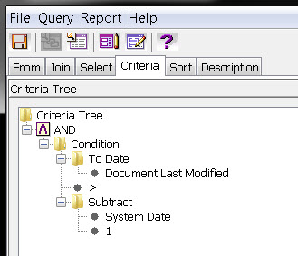

Creating a report in report management to find all object modified today and then schedule it to run on daily basis. Tried with system date function but not giving correct result.

The sysdate function will return the date based on the database's operating system. when you say incorrect result, how incorrect are they?

i need to schedule this report using Data Monitor. Want to execute report daily at specific time. when i used system date function, it gives me 0 results. whereas there are object modified on that Date.
I think this is the format in which it returns the value as include the time as well.

Did you add the criteria like this?
