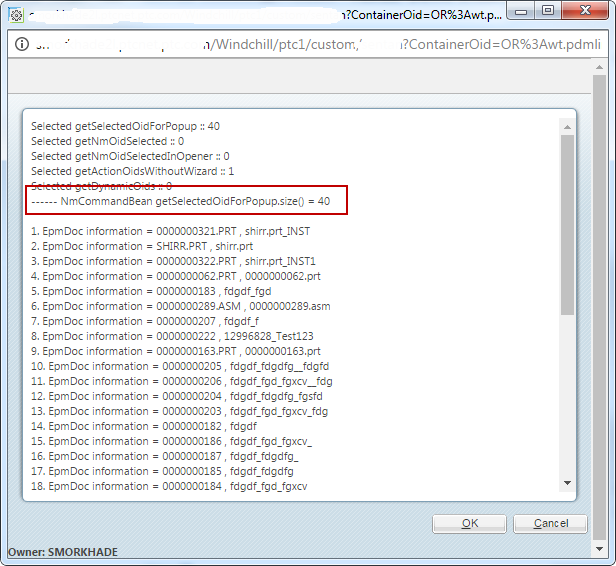

How to get all the objects(Part) added in a table thru NmCommand bean in form processor?
How to get all the objects(Part) added in a table thru NmCommand bean in form processor? What API to use?
ShirishMorkhade
Mar 22, 2017 8:32 PM UTC
Hi Anjali Sharma,
Check this: ArrayList selectOids = commandBean.getSelectedOidForPopup();
Shirish
ash1-VisitorAuthor
Mar 22, 2017 9:04 PM UTC
Thanks Shirish. I will try this.
