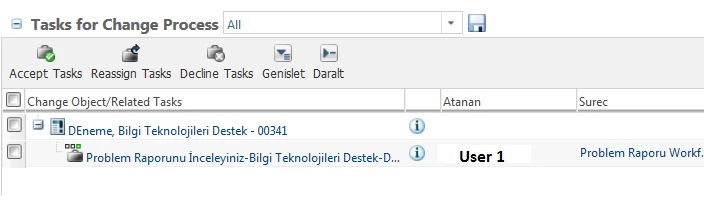

How can I get assignee(User 1) as an attribute from a Problem Report ? Please look at attached file.
Thanks in advance.

Try this:
WTChangeActivity2 changeActivity = <get change activity object>;
Team team = (Team)changeActivity.getTeamId().getObject();
  ArrayList assignees = (ArrayList)team.getRolePrincipalMap().get(Role.toRole("ASSIGNEE"));
  for(Object u : assignees)
       WTPrincipal user = (WTPrincipal)((WTPrincipalReference)u).getObject();
You may need to change role names if you don't use ASSIGNEE as the role.
