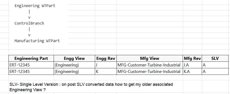

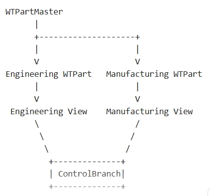

  • user will create the part as Engineering View and go to detail page then click on “CheckOut and Edit action.
  • Here wizard pop , user will select the plants specific selections , plant code and click checkIn
  • now another Part (Manufacturing) part is created
  • Bother are showing in Version History
  • A.1(Engineering)
  • A.B.1(Manufacturing)
  • we are using the older Multi level Version schema and now we are planning to update to Single Level Version
  • how to get my older associated given manufacturing to Engineer view?.
  • I can use simple QuerySpec and any other Links available to get ?
Currently my windchill system is Multi Level Version schema and now planning to move to Single Level Version in WC_13.1
