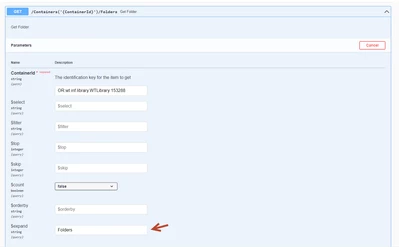

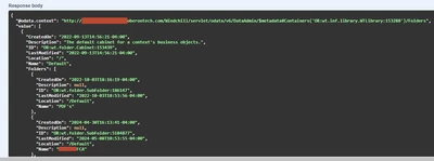

In order to get the subfolder in a given folder via the WRS REST API's, include the $expand parameter with a value of "Folders".
This causes the API to include a Folders objects as part of the JSON response and fills in each of the subfolders.
Search the PTC Support site for Windchill REST Services User Guide for more information on the expand parameter.

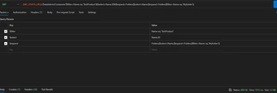

You need to use the '$expand' param. You need to build the expand param based on the level of the folder structure.
Example:
In this case the folder path is "/default/MyFolder"
Thiagarajan
Jan 10, 2025 8:29 PM UTC
I am guessing you are right about the expand parameter, but what you suggested is not working for me. I get a URI is malformed error.
