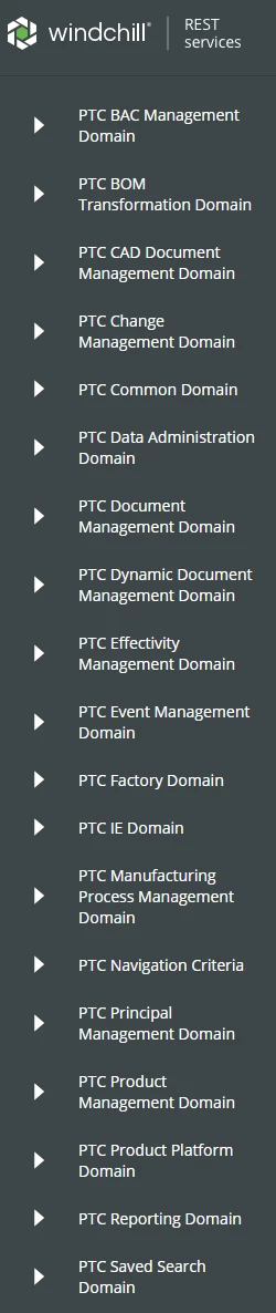

How to get the API JSON files for the Project & Task Management
I am using Windchill PDMLink Release 12.1 and Datecode with CPS 12.1.2.5
How to get the API JSON files for the Project (Create, Update, and Delete actions) & Task Management (task update and completion action)
Here are the errors that I faced
HelesicPetr
Dec 17, 2024 7:41 AM UTC
Hello @twindchill
Login to windchill and check the Windchill REST services
serverAddress/Windchill/netmarkets/html/wrs/doc.html
if the API is there you will find it and you can use it.
If the API does not exist then you have to create own custom one.
PS> I do not believe that a rest API exists  to control Projects and Tasks.
