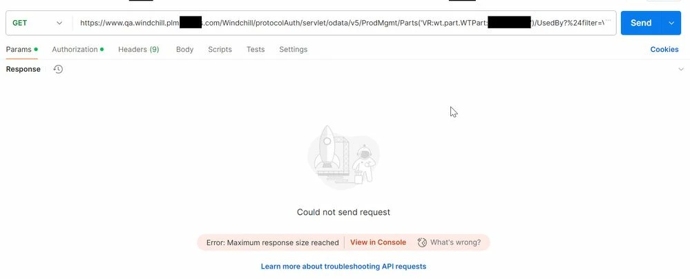

To add further, if I didn't add the query 'ptc.search.latestversion=true' in the API request from Postman I get the below response:
API response when ptc.search.latestversion=true is not addedAPI response when ptc.search.latestversion=true is not added

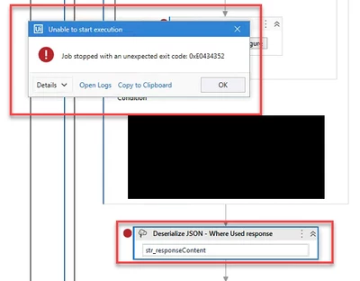

Due to the exceeded response size I need the child level latestversion response. Sometimes while deserializing the json with exceeded response size, the deserialize package throws an unknown exception:

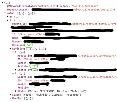

Windchill can only return the last revision where the part is used in. That might not be the latest revision of the assembly.
Example:
Assy1 Revision A:
- Part1
- Part2
Assy1 Revision B:
- Part2
- Part3
If you do Where used for Part1, Windchill will return Assy1 Revision A.
I'm using a workaround for that - expand all the revisions for Where Used parts:
https://windchill.server/Windchill/servlet/odata/ProdMgmt/Parts('OR:wt.part.WTPart:123456789')/UsedBy?$select=Number,State,Revision,Name&$orderby=Number%20asc,Revision%20desc&ptc.search.latestversion=true&$expand=UsedBy($select=Number,State,Revision,Name),Revisions($select=Number,State,Revision)
Then I compare the resulting revision with latest revision:
Unfortunately, I'm not sure how to make it work when you expand it for multiple levels ($expand=UsedBy($levels=max))
