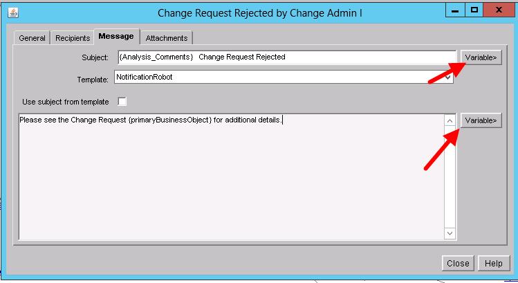

Use below steps
  1. Create workflow variable for example String colour;
  2. In expression robot get the value of colour attribute from PBO use PersistableAdapter API https://support.ptc.com/appserver/cs/view/solution.jsp?n=CS135663
  3. Use color attribute in email robot. i.e. in subject and in body
