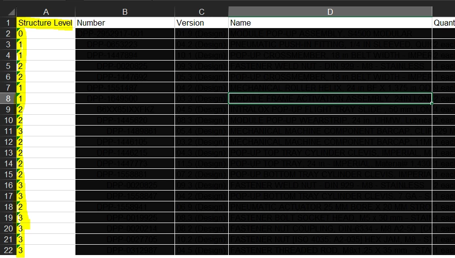

How to get the Structure Level number of each part in a Multi-level BOM
I am trying to get the numerical value of the Structure Level of a part in a mulitlevel BOM via Windchill REST Services, similiar to when exporting a Multi-Level BOM of Material Report under an assemblies structure tab.
The GetPartStructure endpoint doesnt seem to have an attribute specifically for Structure Level. Is there another endpoint or a maybe a param I may be missing?
HelesicPetr
Apr 2, 2024 7:33 AM UTC
Hi @mariaSutton
Structure level is always counted during the generation. so attribute level does not exists in database
You need to calculate the level from the assembly you are standing on. .
