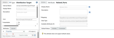

The link between DT and parts is com.ptc.windchill.esi.tgt.ESITargetAssignmentLink
Issue is that many parts may referring to the same DT, some  customer use one DT hence the one DT may reference all parts
we can define an alias attribute on DT type with mapping target@com.ptc.windchill.esi.tgt.ESITargetAssignmentLink~releasableObject^wt.part.WTPart
but it will show all parts

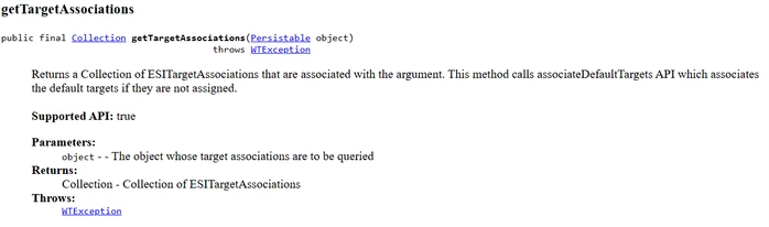

com.ptc.windchill.esi.tgt.ESITargetUtility.getTargetAssociations(Persistable object)
