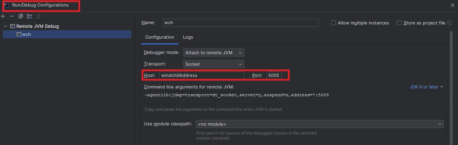

Hi @AKC_301264
Your Windchill should use just one methodserver without bacground.
If you use BG and MS then the configuration is more complicated that you have to set different ports to each method
in InteliJ create new RemoteJVM Debug configuration set the address and port
Copy the Command line arguments for remote
in my case
-agentlib:jdwp=transport=dt_socket,server=y,suspend=n,address=*:5005
set this arguments in the windchill wt.properties file by Windchill shell command.
wt.manager.cmd.MethodServer.debug.args=-agentlib\:jdwp\=transport\=dt_socket,server\=y,suspend\=n,address\=5005
restart the method server.
Then you should be able to connect to the Windchill with debug mode from InteliJ.

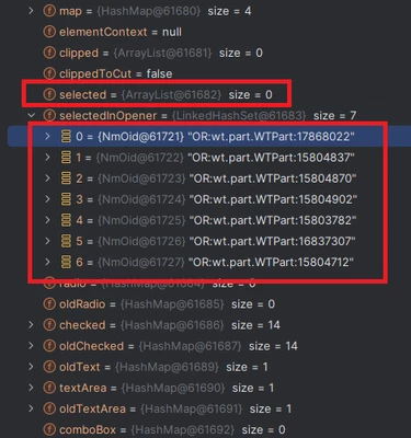

Thanks for the reply Petr. I know the process for  new WTDocument. My challenge is that I am not sure how to use NmComandBean object to get the row informations in the processor that process the wizard.
For your information I am getting POJO data as below in my MVC table
From the above table, I can able to fetch value for Comments entered which is text area (column 5) , attached file (column 6) and selected action (combo box which is column 7). However I am not able to fetch columns 1 and 2 which are specific document's number and description respectively.

Hi @AKC_301264
It depends what object it is.
For example if the row is an object that is identified by number try to get the row object and use getter to get that information..
I guess that the object is just virtual and is not stored anywhere so
try to check the values of all getters from command bean in debug mode when you can stop the operation in IDE and check the actual real variables and data  that are pushed to the commandbean object.
getText
getComboBox
getTextArea
getChecked
PetrH
