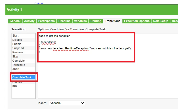

How to hold Activity A without completing Activity B in windchill workflow

You can put a code to the complete transition with condition and throw exception that user needs to wait until the task is finished.

Hi @ukrishnan-3
Can you describe your use case more widely?
You need that the ActivityA can not be completed before the ActivityB ?
Or  do you just need that WF process continue after the ActivityA and B are both completed?

we want need that the ActivityA can not be completed before the ActivityB completed.

Hi @ukrishnan-3
