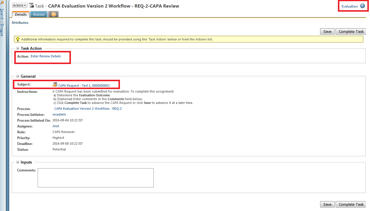

Hi Everyone,
I want to use existing Windchill objects for my workflow tasks. For example, please see below image..
Here you can observe highlighted area Enter Review Details which navigates to respective object's page where default attributes are defined.
Same way, I want to use them in my flow .

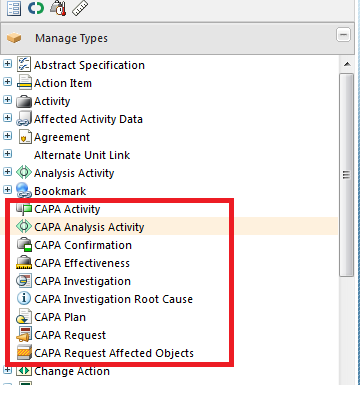

Please guide me for this as I'm new to Customization. Also tell me how to create new objects like below through API.
Thanks In Advance,
Krishna Chaitanya

Hi
You can declare a variable of type object (Windchill Class) in your workflow template as an object. If you make it visible in any user task Windchill will display Object identifier with the url to it. Not sure about the icons those.
