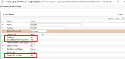

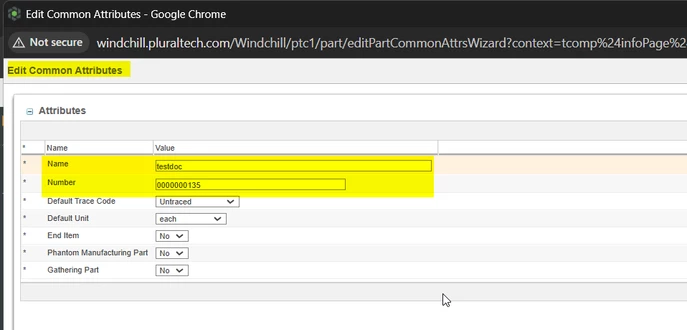

How to make ready only "Name & Number" attributes on Part Edit Common Attribute Page
Version: Windchill 12.1
Use Case: I want make ready only "Name & Number" attributes on Part Edit Common Attribute Page :
Description:
I am unable to figure if I should use data utility or Validator for this.

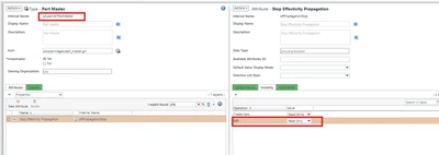

Jan 16, 2025 7:18 PM UTC
You can do tha Oo TB t from UI :
In type and attribute manager find these attributes on WTPartMaster and set visibility to read only on edit  :
Buiꓘa
WT_01021910-MarbleAuthor
Jan 17, 2025 11:07 AM UTC
Thank you @Fadel
I works for other attribute as you show but not foe name & number. I want to do it for name & number.
