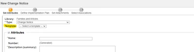

Hi All,
I need to make Template attribute mandatory which is present on Create Change notice Wizard ? How I can do that.
PFA.

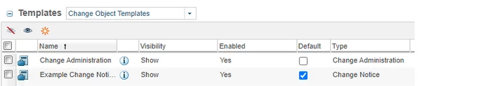

A Data Utility would be my guess. You would have to find the details on that UI element (jcaDebug) and they find the Data Utility it uses. You can either superclass it and tick off required to write your own. I do not think this is as easy as the Type Manager attribute definition.

Hi @BA_10670508 @avillanueva
The template definition is more hardcoded.
And yes DataUtility can help in this issue.
I think more simple way is just set a default preselected template.

Hi @HelesicPetr @avillanueva ,
What can be the selector for this template attribute(for data utility). Because it is not IBA attribute.
