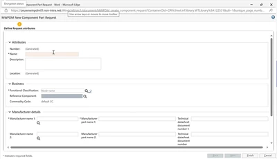

Hi all,
I'm working on a Part request creation form and I need to find a way to create a composite attribute including
 * 1 text field (ie: manufacturer part name)
 * 2 objects references (ie: manufacturer and datasheet)
Those 3 informations can be added one or multiple times
Currently, I have defined 3 sets of 3 attributes inside a Document soft type, create a heavily customized version of WTDocument creation wizard, but I can't neither handle file attachment properly nor handle a fourth (or more) set of data.
My idea is to have an extra custom object that store 3 different inforamtion and add a multi-valued attribute inside Document soft type to store it.
Below a screen shot of current wizard (datasheet upload does not work)
Thanks all for your suggestions.
