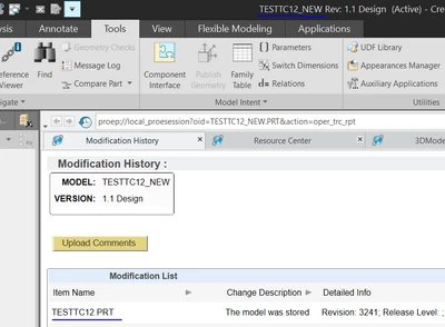

While migrating the older version of the creo drawings from Windchill to Teamcenter, we are getting some unknown sync issue, this issue is exactly happens when we did some changes on latest version of the dependencies.
For example let's say in creo DRW001.drw has the dependencies of PRT001.prt
Let's say these are the latest version available in Windchill.
DRW001.drw - 1.3
PRT001.prt - 1.3
Now we need to migrate the 1.1 version of the DRW001.drw. Also we did renaming on the PRT001.prt as PRT001_NEW.prt on the latest version (1.3)
So after Windchill extraction by "As stored" for the 1.1 version of the drawing, we facing sync issue that PRT001.prt is not in the directory.
Basically what's happening here is, when we rename the part in Windchill, it's getting renamed automatically for all the versions of the part, But in the physical file (File history of the part), it's still having the old name id.
This can be fixed by check out the part and save and again checkout the part, so it can update the new part id in the file history, but still it's only getting updated on the latest version of the part not getting updated in the older version that's already existing in the Windchill.
Is there any way to fix this issue, please let me know
Thanks.

    Our requirement is to standardize the part name in Windchill before migrating into Teamcenter. Actually as you said it renames all the version, but in file history some how it's not syncing.
For example,
The part TESTTC12 has been renamed into TESTTC12_NEW, but in file history it's not saving. This causes error in drawing that " Model "TESTTC12_NEW"  not retrieved.

Sorry to see you go (Windchill to TeamCenter). Note that (I am pretty certain) that when you rename CAD files in Windchill, the actually binary file is not updated. @BenLoosli is correct that rename (name, number or filename) are master attributes and apply for the entire history. So the entire iteration and version history are impacted. BUT, the CAD files as rest in the vaults remain as they were untouched. Creo stores filenames internal as its references to components, formats, drawings, etc. The ONLY time a rename event is passed into a CAD file is as it transferred to a workspace. This is easy to test. Pull up some files in a workspace. Then do a rename in Windchill in a separate browser. Its only when the workspace detects a rename event, does it pass that data and update files locally.
So, if you plan is to migrate data from Windchill without transiting through a workspace on its way to TeamCenter, you've got a big problem.  Even old rename events that occurred might not have made it to all iterations.  It is possible to pull down older versions of files into a workspace however, this will make your transfer of data much more complicated. At least you should limit things to only take the latest iteration of each CAD file version.

So, it sounds like you what to fix previous iteration without actually iterating. To fix iterations in place (meaning without iterating, For example 1.1 remains 1.1).
The following will work:
  1. Locate the content file in the Windchill file vault folder, note the hexadecimal file name. A Java script can be written to do this as well as a Query Builder that takes advantage of Java Method functionality.
  2. Copy the file from vault folder to a working dir.
  3. Copy (Save As) the hexadecimal file in the working dir to the file name it had prior to Windchill renaming. You now have backup copy of hexadecimal file and a copy with the correct Creo Parametric (ProE) filename.
  4. Open the ProE file in a session of ProE .
  5. Rename in ProE to the new name and save the file to disk.
  6. Copy the renamed file saved to disk in step 5 to the hexadecimal file name and then copy it to your file vault overwriting the original hexadecimal file name.
My guess is you any many files that would need to be run through this process. True?
If yes, much of this can be automated.
