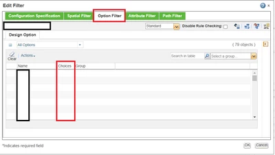

Hi there,
I'm trying to obtain the options from a saved filter. "Choices"

I think I'm sucessfully obtain the filter but i can't reach the Choices from this type. I need to parse the Choices.

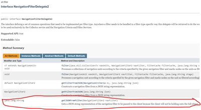

Also i'm trying to get it from NavigationFilter2, i've found a javadoc for this i think i can parse it from the json if i call "getJSONFromFilter(NavigationFilter2 navFilter)"  getJSONFromFilter function.
So i've used code like that;
java.util.List<wt.filter.NavigationFilter2> filters =
 (java.util.List<wt.filter.NavigationFilter2>) navigationCriteria.getFilters();
for (wt.filter.NavigationFilter2 navFilter : filters) {
String jsonRepresentation = wt.filter.NavigationFilterDelegate2.getJSONFromFilter(navFilter);
 System.out.println(jsonRepresentation);
But i couldn't compile this code because NavigationFilterDelegate2 is an interface so i can't call it directly.

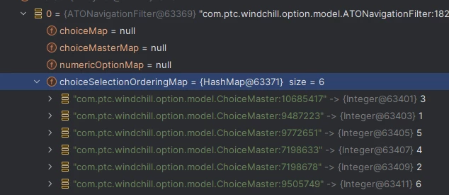

Hi @Anil_SAD
If the Filter contains the Options then it should be an ATONavigationFilter type.
So retype the filter to the mentioned type and use the get methods for the options set and choice map
It works. btw if you are not sure if the user has an access to the saved filter, then change the active user to an Administrator for the time.
NavigationCriteria crit = NavigationCriteriaHelper.service.getNavigationCriteria("MYVARIANT", true);
System.out.println(crit.toString());
Collection<NavigationFilter2> filters = crit.getFilters();
for (NavigationFilter2 navigationFilter2 : filters)
	if (navigationFilter2 instanceof ATONavigationFilter)
		ATONavigationFilter atonFilter = (ATONavigationFilter) navigationFilter2;
		System.out.println(atonFilter.getOptionSet().toString());
		System.out.println(atonFilter.getFilterType());
		System.out.println(atonFilter.getChoiceMap().toString());

Thank you @HelesicPetr , i've finally succesfully done it. I'm able to obtain all choice names by this code 🙂
