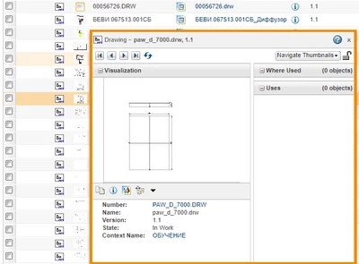

On a third-party site, we display a list of drawings from Windchill. Tell me, please, are there ready-made solutions so that you can view a thumbnail of a drawing on a third-party site?
Now I use the REST API to first get the ID by designation, and then get the visualization by drawing ID

Hi @VladiSlav
I don't think there is ready-made solution :for the thumbnail picture.
I usually crate own function to get the picture URL in xml format to download it in the third-party SW.
There is an api to generate download url for specific content.
PetrH
