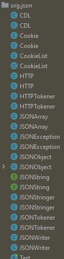

Windchill library contains a json.jar library file in <WTHOME>\codebase\lib\json.jar
the jar contains all what you needs to manipulate with a json format.
package org.json
hope this can help;
PS> sure there are others packages
package org.json
hope this can help;
<WTHOME>\srclib\json-smart.jar
<WTHOME>\srclib\json-simple.jar
